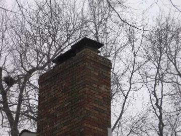

As far as the size of the flue tile at the top of the chimney... which was what his concern was, it looks much bigger to me then 6 x 6. See attached. The flue itself is much larger, never really getting much smaller then the 6 x 36 size of the damper. There are 3 flue tiles in this pci..the two larger ones are for the first and secon floor fireplaces and the small one is for the heater...
Still going to insist on insulation...

You only insulate if the Chimney is really large? I looked up today with a light and i would guess that it probably is about 6x12. Its all brick, not usre what untiled means...

If you look up in your chimney, and you see bricks all the way up(or as far as you can see), your chimney is untiled. Most houses biult from the 40's and later are tiled. Take a peek --> no bricks = :cheese:
Wood-fan-atic,
Thanks, I took a look up and the side wall that is exposed on the outside of the house is brick. The opposite wall faces another chimney and that appears to have a coating of motar, as does the inside wall that faces the house and the wall that faces away from the house..
So is it tiled or not??? House was built in 1976...

"Tiled" is refering to the clay liner that is sticking out of the top. Yours appears to be clay lined, I would also guess the flue is 12"x12".
