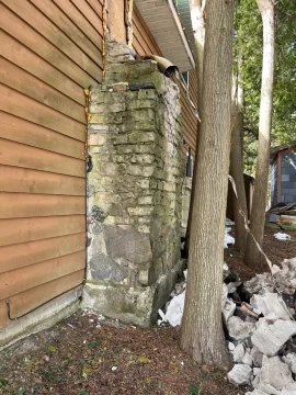

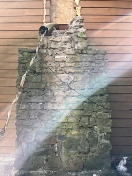

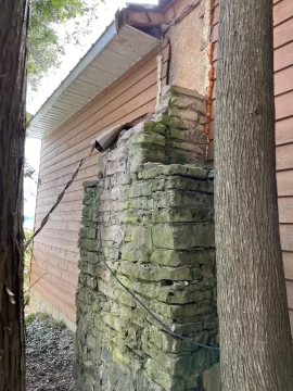

Thanks Be! Pics attached. Unfortunately there isn’t one showing a clear pic of the top but hopefully you can get the gist. You can see the flexible liner coming out of the top of the stone. We were thinking of demolishing the chimney and converting to a through the wall SS fitting and insulated SS chimney with siding behind. Plan B would be keep what’s left of the chimney and adapting to SS from there up. The main reason we want to get away from liner-in-masonry is that it takes a long time with a space heater blowing right into our Pacific Energy insert to heat the chimney enough to get convection going so we don’t fill the building with smoke when we light a fire. The second reason is that snow that collected behind the chimney melted and leaked [Hearth.com] Broken chimney on 1970s Heatilator through our standing seam steel roof.

That's a sad sight. I'm not sure if the snow was the main issue or poor construction of chimney. The stone work looks pretty loose, almost like it was a DIY install. @bholler may have some options including putting a metal chimney on the old heatilator but I am not sure that will be less expensive once the carpentry is included.

It is absolutely possible to run a section of liner to an adapter plate then use prefab chimney. But honestly that chimney structure looks really rough. Im not sure i would do it
Thanks for replies, much appreciated. Yes it is DIY, and over 50 yrs old. And we had a ton of snow this winter. My preference would be to demolish the existing stone and replace with insulated SS but the local business that installed the Pacific Energy insert with a flexible SS liner through the clay flue said it is impossible without demolishing the fieldstone fireplace inside the building and basically starting from scratch which is not an option for us because the fieldstone fireplace is beautiful and sturdy. (For context, the current building was built up to/around the old fireplace so we could keep the original footprint of the building closer to the lot line than a new build would allow.)
