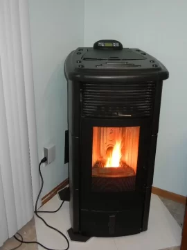

The good, really put out the heat, quiet, german made fans. A lot of variability in setting up controls.
The bad, need frequent cleaning and high quality pellets. May need some minor finishing touches in sealing up hopper etc.
We use the unit as a shouldering stove and to bump the upstairs heat when the Harman downstairs is not quite getting enough heat upstairs. Typical on time is about an hour in the AM and PM. Takes usually under 5 minutes to ignite and a couple more to start shoving heat into room. LBT a must to keep performing without the fuss of pulling the back chamber ports.

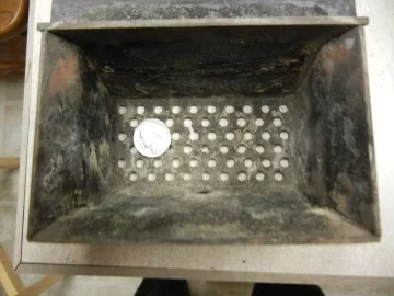

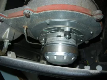

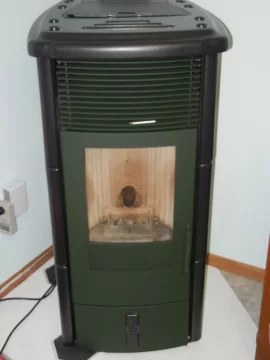

Couple more pictures. After new paint to match room. Exhaust fan. Burn pot. Corner install with a 45 elbow thru wall with no rise in pipe and stove has no power out issue at all. Minimal hearth needed below unit as the burn unit is well above floor which is great for our install as it blows air over the dining table. Like coolnuke cleaned about twice a week as the ashpan is small. Cant find my downloaded manuals.
