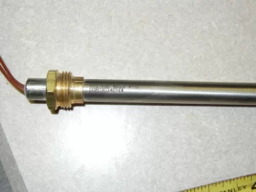

    Just adding some replacement parts info :
    I ordered a spare ignitor and burn-pot for my Elena from North Forge Heating, Annville PA, (talk to Barry (717) 867 1744).
    The Ignitor dimensions are 6 inches long by 10 mm diameter. A brass threaded (metric threads) ferrule is pressed on one end.
    It is a 250W 110V heater, marked "HT51698 W250 V110 0080902401 CE"
    I think the OEM manufacturer is European.
    The room temp resistance is 46 ohms.
    The burn-pot part number is 55009
  24. Bioburner
    Bioburner
    Moderator 2.
    Staff Member
    Aug 4, 2012
    7,292
    1,560
    West central Mn
  25. Pelleting In NJ
    Pelleting In NJ
    Feeling the Heat 2.
    Sep 26, 2011
    443
    73
    Central NJ
    $60 for the ignitor, $90 for the burn-pot.
    Thanks for posting the ignitor picture.
