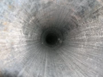

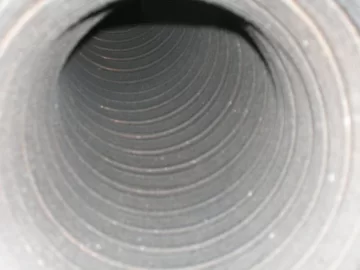

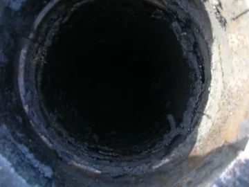

Update - Took the cap off, and snapped a couple of pics. You can see loose flaky creosote for the top 2-3 ft of colder pipe, but then it really seems to get less, and more powdery. I now have to go to the hardware store and pick up a brush / rods, or some PVC. Will be cleaning from the top.
Nice clear day here, but not warm outside - approx -18C + windchill - nice and sunny though!!
Let me know if anything looks alarming in the photos, please!!!

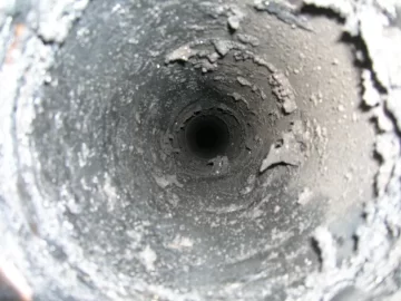

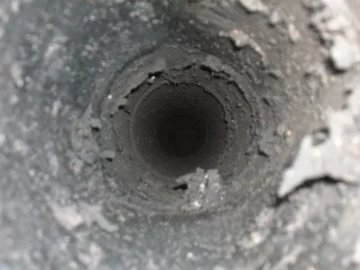

a couple more pics. You can really see the glossy, flaky stuff at the lip!

Alarming?
I'd have stuck the cap back on and bought a brush and some rods sometime next week and cleaned it in the spring. ;) But, while it's apart, might as well give her a stroke or two.
Not enough creosote in there to hazard stuff too badly if it did light off...

Good to hear that it doesn't look excessive! I am used to working / being out in the cold, so it's still a nice day to do a bit of work outside! Figured if I clean it now, we will defintiely be good till the spring. Like to see how much comes out, as a bit of a benchmark as well.
Thanks for the confirmation! This forum has been a huge help this past few months. Thanks to all who contribute!!

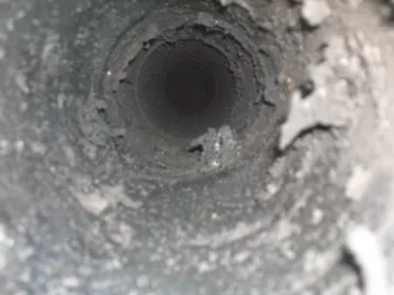

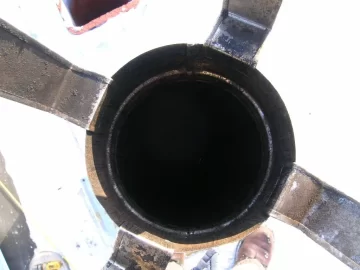

My chimney was the oppsoite of yours - clean as a whistle near the stove, and dirty in the last few feet. I know I should have it insulated, or cut the top piece shorter, as it goes about 4 ft above the clay chimney. The sweep who installed the liner said we could cut it shorter if we wanted, but to try that and see how it worked.
Anyway, cleaned the chimney. Had a hard time getting the brusk down the top couple feet, due to the buildup. I used the poly brush, and the bristles are quite stiff. Once I got it cleaned out, it was much easier to pull in / out.
Only got about 1/2 gallon of flaky, shiney creosote, so I feel pretty good about the way we have been burning.
here's a couple pic of the bottom section before cleaning!

and the top section after cleaning:
