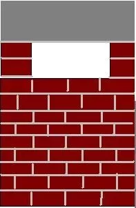

Make fun of me all you want, but I get dizzy on ladders and my roof is STEEP. It's a safety issue here. If I pull the elbow off, is there any reason I can't clean it from the bottom?
Plus, I have one of those big square masonry chimney tops with a huge stone on top that leaves about 8-12" from the brick to the top... looks like this:
  • [Hearth.com] Is it possible to clean the liner from bottom up?
