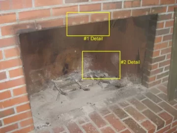

I thought it was a masonry fireplace, and I'm all set to get an Englander 30 and slide it in. But... the back of the firebox is metal. The floor is brick, there's no metal around the opening of the fireplace (all masonry there), the chimney is tile lined. It's clearly not your typical pre-fab. As far as I know it's original to the house, which was built in '78.
So, am I safe putting an Englander in here? I attached a photo, which I realize doesn't show a whole lot. I can take better ones tonight.

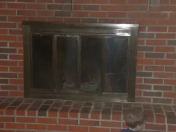

Are there any vents on the face of the fireplace, behind the glass doors?
Heatalator liner,got one my self and insert works well.But as asked i don't see
any intake vents on bottom or vents on top of f/p facing.

As far as I know, you can not mess with the box itself. If it has vents, they are not to be covered. Rehingd. I would say as long as there are no vents, then yes its a "Heatilator". People get confused because Heatilator is a brand, but it has turned into a more generic term. As long as there are no vents on the face of the fireplace, then you would be ok to have a surround to seal off your stove. If im wrong someone will correct me.
There are no vents.

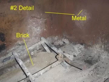

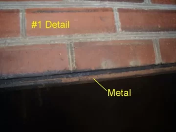

I took some more detailed pics. My real question is whether it's safe to slide a stove in here. It will be a few inches (4-8) from the back wall of the fireplace, and about 10-12" from each side. I won't be closing it in at all... plenty of air circulation.
The entire firebox is metal, except for the floor which is brick.

Excellent. Thank you. The info in that link looks exactly like what I have.
