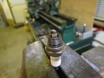

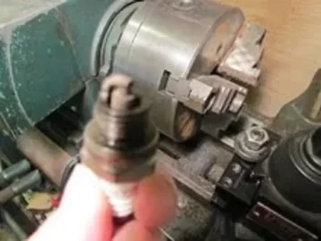

I have worked on and raced two stroke engines for about fifty years. I ALWAYS do a spark plug color check after "super tuning" any engine.
As far as determining amount of oil in gas--NO--lean or rich running condition --YES.
To check, I run the chainsaw in a long cut after installing a new sparkplug in a warmed up engine. I cut the ignition immediately and check plug color.

By "super tuning" I am referring to muffler mod and carb limiter removal and adjusting to four stroke in the cut. When I am satisfied it is right, I then do a plug check, just for verification. Not that I am that good--but usually it is light tan or a light shade of grey. In most cases I always use the manufacturer recommended spark plug and it will be the right heat range.
You can have a light tan color to the plug and install a hotter heat range plug and then get a near white color.
