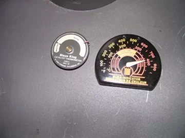

I am not understanding your problem with your temps. 550F is nothing. If you are referencing from this , in my picture then you must understand that the thermometer is labeled out for flue temps NOT stove top.
