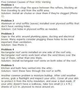

....as for roof venting, this was me in the mid 1980's installing soffet venting in our attic (very important to let fresh air into the attic via the soffet area). ......terrible job but must be done especially on older homes.
also , some good points about attic venting..... see pics below. ...... hope some of this helps ya..... cc :cheese:
.....click on pics to enlarge......
