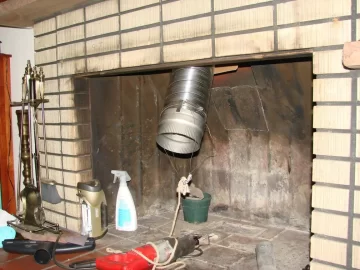

Make sure to make one of these. 3 pieces of wire with a rope, makes pulling through damper way easier.
I also found another helpful tip, the small ridges of the liner were getting cought up on the damper area i cut out.
I slid a piece of cardboard between the cut metal and the liner, slid right through no problem. Obviously make sure you remove
the cardboard when you are done.
