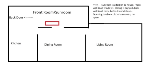

Oye, so many issues. I think I should have re-searched a bit more. Recently had a regency f2400 installed in my front sunroom (addition to house). It's rated up to 2200sqft, and 8 hour burn times. My house is 1800, and I'm getting about 3.5- 5ish, if packed in good (fresh splits test around 18%).

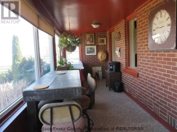

Windows are double pane, newer. But...the brick. I thought it would be more like thermal mass, keeping the heat in. But now, I'm not too sure...
Shown is an older pic, from when I purchased the house. The stove is right where the clock is, on that brick wall. Single wall pipe.
Should I insulate the brick? And easiest way?
Thank you in advance!

The brick will suck up heat but most of it will end up back in the house eventually. In my opinion the windows are the problem.

What's not shown is on the "bottom" side of the kitchen is a stairwell, that goes from our bedroom, into the dining room (which also has windows on that outer side of the house), and bathroom is at the "bottom" of our living room. So that's a path way. Above the kitchen/dining and living room, is a 2nd story with our bedrooms, and that presented issues as well (cost of pipe and windows in the way).
The brick is not the problem. Heat absorbed there has nowhere else to go but back into the sunroom or, eventually, into the dining room.
Virtually all of your radiant heat is, um, radiating out into the cold, cold world. Double pane or not, radiant heat passes right through glass.

Radiant heat goes in a straight line until stopped by something - a wall, furniture, the cat - where it is absorbed. You feel radiant heat off of a stove when you stand close to the stove. It is most noticeable when right in front of the glass in the stove door. It feels much warmer there because the radiant heat from combustion is reaching you almost unimpeded. Sadly, with those windows, it continues unimpeded right outside. The black stove box radiates heat as well, of course, but the air that comes in contact with the hot surface also picks up the heat and circulates about in a process known as "convection".
Curtains would help some, I suppose, but would scare me to death that close to a front loading stove. We have not even addressed the fact that more than 50% of your wall has an R value of about 2.
Radiant heat is almost entirely unaffected by fans.
How much radiant vs. convection heat comes off of your stove? I don't know. Rather a lot of radiant early in the burn cycle, for sure. Once in the coaling stage it may become almost entirely convective.
The Regency 2400 is a 2.3 cu. ft. stove. An eight hour burn time is at the outer edge even of normal manufacturer puffery. With good hardwood you should be able to operate on four to six hour cycles.

I'll go with the majority and say it's the windows. Plus the fact that you're in Canada and it's damn cold up there! Insulated curtains to the floor all the way along the exterior wall and leave 1 open for light (provided your not to close to the stove) or move the stove into the dining room. Or get lots of wood and you'll at least keep the frost off the windows.

Windows. They are acting the same as concrete walls in a cold basement. If you want to prove this just cover them with rigid insulation but that would look like crap.

Are your windows cold to the touch? Should be all the indication needed. They are serving to radiate the cold of outside, directly to your indoors. The layout, and the stove being where it is, is really creating quite an 8 ball to be behind.
