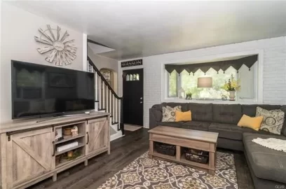

I just moved into a house that's 1,137 sq feet. After doing much research on wood-stoves I have my heart set on a Fireview from Woodstock. Being that the company sends the stove direct, I called up a local woodstove store to see about installation. When I called them they told me that the stove is too big for my house (they also sell wood-stoves and were trying to talk me into looking at stoves that they had for sale. . .) Anyway, I called someone from CSIA and he came out and said that the manufacturer says it heats 900-1600 sq ft. and I should be okay. I would like to get other people's opinions on this. My question is . . . when I figure in the downstairs dimensions, I get 769 sq feet (the remaining 368 sq ft is upstairs), my living room alone is only 12 X 15 which is 240 sq feet, do you think that my house/living room is too small for a Fireview? Will I be heating us out? Below are pictures of part of my downstairs from when it was listed for sale so that you can see the layout. Please know that the furnishings and electric fireplace in the pictures are not mine, but were the previous owners'. Thanks for any input!!
Livingroom: back archway leads to a small hallway where there is a bedroom, bathroom and another bedroom.

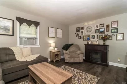

Front of Living-room: Front archway leads to kitchen - stairway goes to 2 bedrooms on the upper level.

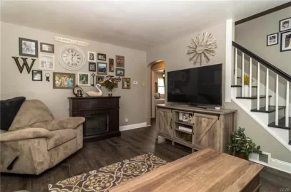

Complete view of living-room

The Fireview has a nice range of output and should be ok once it gets cold outside. The stove will primarily be heating about 600 sq ft (LR + upstairs) unless some sort of fan is used to move some heat through the side rooms. Those archways will block heat from convecting into them, so it will mostly head upstairs.
