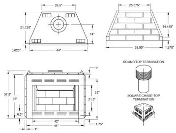

The good news is that the fireplace is UL127 tested. How large an area will you be trying to heat?
FP dimensions:
[Hearth.com] Is there an insert for me..?
For starters, it looks like an Osburn 1800i will fit.
FP dimensions:
