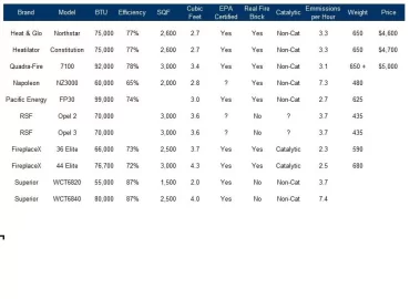

Like Iron and SouthernHeat, I will be purchasing a zero clearance fireplace. I've done a lot of research as well.
Please see my 'Zero Clearance Fireplaces Specs Sheet' (attached). My list shows many of the ZC models talked about in this thread and other ZC threads, but instead of toggling between websites - this list has all the relevant characteristics in one place.
Man y thanks to David Ervin for his NorthStar expertise as I'm leaning towards the NorthStar unit (all around good feeback from NorthStart owners on this site). My specific concern is ALL the dealers in my area of the country (Long Island New York) get absolutely TERRIBLE reviews. And thanks to Hearth members I've learned that the dealer / installer is probably more important than the actual model you select.
I hope my ZC Specs sheet helps.
