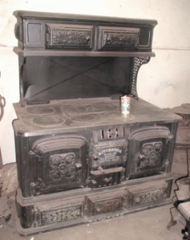

Some times, in some places, and for some things: Big be better.
  • [Hearth.com] is there such a thing as a stove too big?
Too big?
Maybe
(broken link removed)
That is a beauty of a kitchen stove, from an estate no doubt. Much bigger that the run of themill not for heating though. A friend sent me a picture of a stove in Ireland, it was just the firebox and oven, the fire box was like our stoves desighed for wood and peat logs, you could heat your house and burn your bread too. If I can find it later I'll post it.
