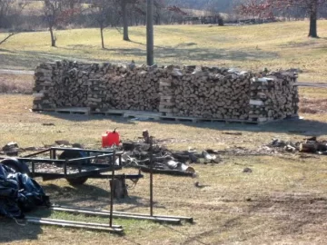

I paid 300 for this one - 6x8 - and it is very handy for hauling wood around the yard and loads out of the woods with the quad. I rarely go above the rails with green rounds but heap it pretty good for short trips from the pile to the stacks with splits(short trips)
It currently has a tilt bed making quad loading rather easy but eventually I will refab it with a tilt gate of expanded metal and weld the bed solid to the tongue. I will also add a wolmanized bed when the expanded metal wears out.
I am thinking 3 face of green is asking a little much from the trailer and van depending on distance you plan to haul.
When I need to go heavy I borrow my friends dual axle and recruit help to load/unload!!
