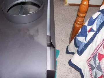

Is this area for the blower also a heat shield of sorts???
tlhfirelion
Feeling the Heat
Aug 6, 2007
452
I don't have the blower yet but this is where it connects and sends the air up and out. This air void behind the stove....is this also a heat shield all be it possibly an unintentional one? Just curious if that would affect my clearance from the backside. Thanks!
  • [Hearth.com] Is this area for the blower also a heat shield of sorts???
Yep. It is the heat shield and reduces the rear clearance. The blower is just along for the ride and to move the air through it faster.
Blower or no blower makes no difference on the clearance requirement.
ok so my manual says a rear clearance of 15" is required. Is this with this heat shield or without it? It came with it so I assume it is 15" with this heat shield in place like it is. I can't find anything in my manual that states it would be less with this in place. hhhmmm....odd.
It is 15". The thing is welded onto the stove. Not optional.
right on thanks. Do you happen to know if other heat shields are an option with this stove? Maybe I should look into some. I don't even know what they look like!
