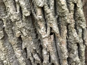

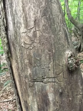

Is this Ash and death result of Emerald Ash Borer?

yes, it appears to be ash borer damage. by the amount of exposed wood in your pictures i assume your tree has been dead for a season or two already. in my experience with borer killed ash trees in a woodland setting such as yours 1 year is all it takes for mycelium(rot) to take advantage of the exposed wounds(borer holes, woodpecker eating said borers) on that tree (standing or lying makes no difference). your woodlot looks like it could support a healthy population of mycelium with all the other deadfall and damaged trees, i am not certain with your northern climate though. ever see mushrooms on the forest floor, fallen branches, stumps?
you may prolong the inevitable by stripping the bark off and reducing the moisture holding qualities of that tree. things dont rot (as fast) without moisture(mycelium doesnt grow(as fast)). you might as well css if you plan on that much work, IMO
my recommendation is to process this tree as soon as you are willing and able. i have had ash trees(30"+ dbh) killed by the borer and snapped 15-20' up due to rot(mycelium). these tops are now hung into a neighboring tree and the area is too dangerous to cut in. this tree is also useless now since i cant get to it with large equip and remove the 24" snag hanging above my head. lot of wood in a 30" 70' forest grown ash.

I can't quite make out the shape of exit hole from your pic.
For a firm ID look at the exit holes:
* D-shaped in ash trees is confirmation for EAB. Pull bark. EAB limits itself to the phloem (just beneath bark) and will have S-shaped galleries, and "emerald ash borer larvae pack their frass tightly within their galleries". There is a good pic on linked OSU factsheet below - very characteristic. EAB infests healthy ash too.
* oval shaped in ash is indicative for red-headed borer, a native borer. "Redheaded ash borer infestations can also be distinguished from EAB by the presence of large (1/4–3/8 inch wide) oval exit holes that extend deep into the trunk." They are are less strongly S-shaped and the galleries are sparser. They Infest weakened trees and freshly cut trees.
This is good link to distinguish between borers: http://ohioline.osu.edu/factsheet/ent-77
I reaffirm Ashful's warning about felling ash that's been dead for some time, or for an unknown period. Decay quickly alters (and in uneven and various parts of tree) altering and making its strength unpredictable. Add other factors (e.g. lean) and it can be hazardous, even for professional cutters. If not familiar with dropping EAB infested trees, perhaps it's best to pass it up and look for easier and safer pickings.
