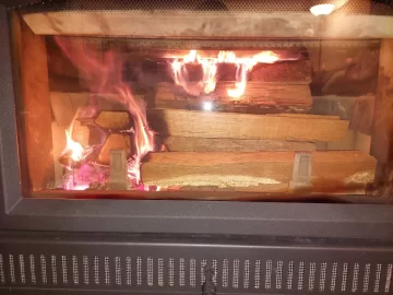

Is this considered secondary burn?
d.sebens
Oct 26, 2021
89
White Heath Illinois
Is the main fire in this picture primary or secondary combustion? I would assume this is mainly primary. What I would consider secondary is the turbulent flaming jets that come out of my secondaries. I hear of people talking about turning down until the secondaries are “lazy”. I don’t really ever see lazy secondaries. Sometimes I will see pretty flame fronts propagate through the box when turned down though.
stoveliker
Nov 17, 2019
7,261
Long Island NY
hard to say for your pic (w/o video to see if they're "connected" to the wood or not).
I (can) have secondary flames (if tuned to the parameters that allow this) - but no secondary air. Those are always "lazy" (and often bluish-purple).
So it depends on the stove configuration. I don't think there is a "standard" here (even if the ubiquitous tube stove folks set expectations of secondary flames).
I'd not aim for secondary flames per se, I'd aim for 1. the right amount of heat WITH 2. no smoke outside. However the latter happens does not matter, THAT it happens means you're golden (and efficient).
d.sebens
Oct 26, 2021
89
That’s really what I do. I’m getting used to how this operates. I was just curious what people are calling secondary flames. That picture in real life to me looked like primary combustion but it was really lazy flowing flames.

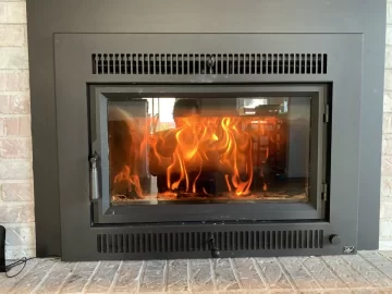

Do you feel your secondaries look like torch flames when the fire is really going? That’s the majority of secondary action I see on mine. That may also be because I usually stack all the way up to touching the tubes.

To be honest, the flames on your pic look like either wet wood or the air being pulled back by increments that are too dramatic. The flames don't look like what I typically see on a "clean burn" and I see the glass is a little blacker than I might expect.

That picture was before it was fully up to temp. The wood is a about 22%, I fully expect next seasons woods (already split) to operate different.
The soot at the bottom seems to happen when I start the insert on a full load when cold. It is probably tied to moisture still, but what I experience is as it warms up it starts outgassing faster than it can consume since the fire isn’t large enough. This doesn’t seem to happen when I do a hot reload.

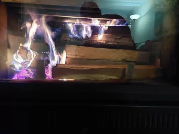

Here is are 2 examples of secondary flames.
bigealta has the secondary burn happening for sure, check out my avatar those are secondaries with very dry wood and pushing a little harder; that rolling flame at the top.
My 'secondaries' only look like that on start up not during shutdown operation. That just looks like flames forced through the baffle. My real secondaries look awesome and shoot down about 6-8 inches. They're bluish and like a torch. They don't ignite until they're about 1-2 inches out of the baffle. They're awesome.
I've most often heard "lazy" used in reference to the flames coming off the wood. When those are lazy, the secondary flame can be blasting!
