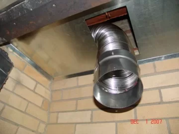

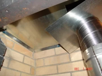

and here is mine being installed to give you an idea
so the answer to your question is no thats not a block off plate but MAKE SURE YOU GET when they do your install
good luck and post pics!!!!

Drayu said:
Thanks iceman! Very helpful! Another quick question, can I use sheet metal from home depot? or should I look for something else?
The galvanized from home depot is what most of us used. It will work just fine.
i didn't get mine from there because it was 30 gauge and someone around here said 26 or lower mine was 22 from a sheet metal company
30, 26, 22, Any of these are fine. Your making a block off plate, its not supporting anything, your not making the Taj Mahal. Just make sure you get one in there,
