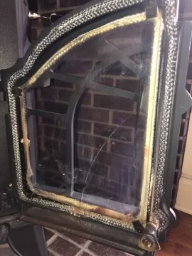

I have a Quadra-Fire Isle Royale purchased in 2010. It has been doing well. A few days ago I cleaned out the ashes in the morning when the stove was cold. There was some soot on the door glass. I cleaned the glass by using a damp paper towel dipped in ashes. I then used a clean paper towel with a small amount of water to do the final cleaning. As soon as I touched the towel to the glass, I heard a loud pop and found a crack developed in the glass (see photo).
I had used very little pressure on the glass. I wondered if the glass was warm, but no it measured 71 deg F. The fire would burned out not long after midnight, and my cleaning was about 9am..
Since I bought the stove, I never replaced the original door-glass gaskets or adjusted the screws on the clips holding the glass in.
I have a new glass and 1/4" gasket arriving soon. My question is do you have any advice on replacing the glass - especially how to adjust the torque on the screws holding the glass clips in place.

Bummer. There are good directions on page 29 of the manual for replacing the glass. Don't overtighten. Just snug up the clips until the glass does not move.
