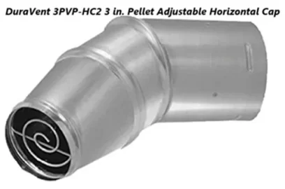

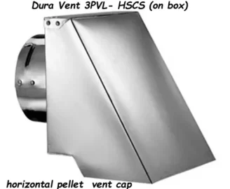

Last night after the post 19 above in this thread, before going to bed, I increased the temp as a further test. Temps here got down to 6* or 7* F last night, got up at 10 AM this morning, Stove looked like last night, very little ash, putting out the BTUs.
After my mess creation with leaf blower up through the clean out tee yesterday, I have come up with a plan to fabricate an adapter to let me hook my large blower under the tee, it's long end pointed up through the tee, past that branch to stove, and being 115 vac I can set the button and plug it in from a safe place and avoid the soot shower. My last venturi tapered like flu vent end directed ash over yonder, this newest rectangle one just vents it down but it is not affected by winds so much. I had added the open mesh critter blocker (which just snaps in secured with a hook so maybe I just climb up and remove it during stove season?)

I remove my exhaust terminations when I clean the stoves and use a copper wire brush to clean those out.

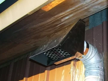

Last week or so, ..... etc .... I knew the stove was closed, and I saw that up there at the new horizontal vent, where I had put a pretty open mesh to keep animals, birds out, half the holes were blocked. I had looked there a few times weeks ago, stove was then running good, but I let curiosity win. I pulled the trigger, instantly the holes opened and it rained black powder on me a lot.

Well, so far, stove has been exemplary in it's running, and the glass does not blacken since then either. I have given thought to how to prevent a black soot shower, that was a huge mess. Wife said she never saw me so covered, even found some black ash leading to the laundry dump that just fell off me I guess. That older tapered termination had directed ash horizontally 15 feet outward across the yard, this new rectangular sheltered termination breathes good, but when blown out with such force as it did that day, it gets directed straight down. I have a couple options, but now I know. ;)
