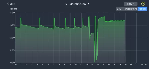

Update: I had bought two different battery chargers when I first started. On the chart I took today, the first one I tried is on the left. Then I went snowshoeing, and the truck barely started (I carry a spare battery now in the back just in case). The second one I bought, I had tried it on my sump pump battery with a voltage current meter. I could see it did a nice job of floating the voltage. The other one I put on the truck seems to "shut off" and restart. I have an AGM in the Jeep which runs a higher voltage than a flooded LA. Today I switched them out. You can see on the right, how the voltage is floating. It will go to zero mA for a few seconds, then to 500mA for a few seconds as I observed it on my sump pump. The saga continues until the warm weather.

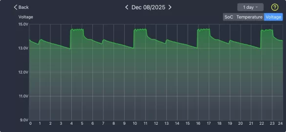

Followup - I broke down and bought a good battery from Canadian Tire with a 5 year warranty. I brought my meter to the store with me to check the voltage. It was made this year, and the volts were 12.8 or so. I charged it up at home, and tested it with my little battery tester. The CCA's were over 900, and it is rated for 800. The milliohms were 25% less than my "Bad" Battery. The people who sold me the "bad" battery refunded me for most of the money. Canadian Tire had a $50 cash reward point sale. Here are some %Charge and Voltage curves for a couple of short trips. I am liking the new battery. I could barely start the jeep when out shopping if I did a bunch of short trips from one store to the other. The other battery still works, and I will put it on my pellet stove system along with my other AGM.
