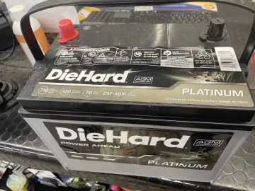

We found that Advance Auto parts now sells DiHard and their platinum AGM version is one of the best for the money. Also our local outlet has one in stock for $204.95 plus the $22.95 core charge.

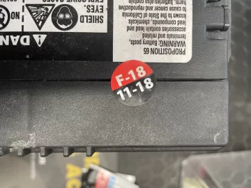

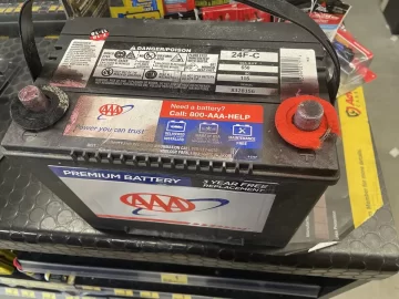

So we zipped out the old battery which was a 3 year triple A battery dated 11/2018. I guess it really at the end of it’s 3 year life.

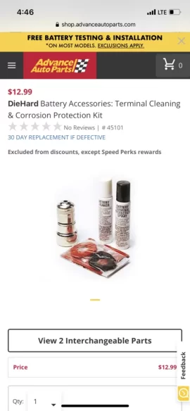

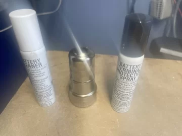

We also got the install packet with the protector spray, cleaner spray, felt anti corrosion rings and hand wipes for cleanup for $12.99. Prior to doing this I picked up a very convenient 10 MM ratchet at Tractor Supply for only $10.99 to make the job that much easier!

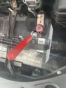

Well once we figured out how to pull out the plastic anchors that hold the plastic shroud over the front battery hold down clamp the rest was a piece of cake.
[Hearth.com] Replacing a car battery is not quite the same as the old days!
The old familiar hold down nut and post was quite rusty so the drill driver and wire wheel cleaned that up quick!
Then after removing the 10 MM hold down nut and just loosening the nut under the plastic shroud we could swing the bracket away, ratchet loose the battery terminals and zip out the battery and clean the plastic battery pan with paper towel and some 409 spray cleaner.
Just reversing the steps, adding the new corrosion rings and bing the new battery was in. Then we had to set the car clock back up and all the radio station buttons! I miss those old mechanical buttons you just pull out and push in to set! They do not screw up when you change batteries!
In summary the new battery has 710 cold cranking amps and the old battery had only 650 cold cranking amps.

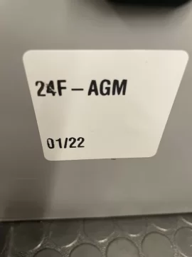

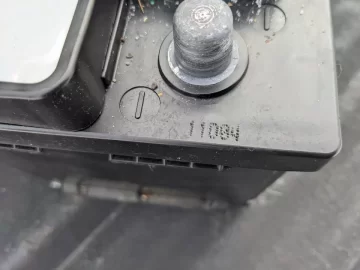

Pic 1-2 old AAA battery only 650 cold cranking amps
Pic 3 - cleaner spray, protector spray, wire cleaner.
Pic 4-5 New Advance Auto parts DiHard 710 cold cranking amps.

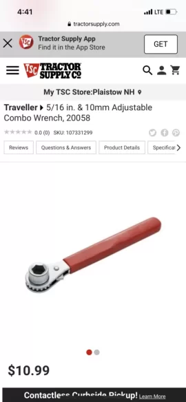

Pic 6 - 10 MM battery ratchet
Pic 7 - battery wrench
Pic 8 - Auto battery cleaning kit

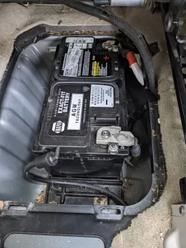

I had a 2016 Escape - I wish it was that easy. Had to take off the brake fluid reservoir, the wiper arms and the shroud because the battery is almost up against the firewall. No other way to finagle it out and in. Not sure about the engineering behind that decision.
Have to also reset the BMS (battery management system) on my '14 Escape. Easy to do with FORSCAN.

Took me 1/2 hour to find the battery in a new Jeep Cherokee. It's under the passenger seat with jump start posts under the hood. Wandered around the darn thing for awhile before I admitted defeat and got the manual out.
Hauled a Cooper Mini out of the corner of a garage at work that was parked in 17. I was going to be a nice guy and replace the battery until I saw where the idiots stuffed it under the cowl.

I also don’t bother with those washers and spray. Terminal wire brush and a thin smear of chassis grease on the posts then put the clamps on. Done.

I just replaced the battery in my 2011 Durango. Same place and it's actually pretty easy to get out of there. Original battery almost celebrated its 11th birthday. Price wasn't too bad, about $180 at Napa.
Crazy thing was it still started the car just fine, earlier in the week it threw a bunch of codes when I tried to remote start it. Some misfire codes and some immobilizer codes, stuck a meter on the battery and it was reading 11.2v 30 minutes after shut down. On crank it dropped to 7v. Should've vacuumed but it was 15 degrees in the driveway.
