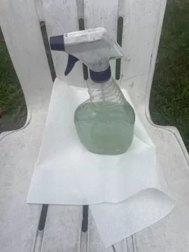

2. Using a gentle cleaner, spray on plastic headlight lens and wipe off the dirt. I used a vinegar solution in a spray bottle.

Pic 7 - Spray cleaner and wipe off
