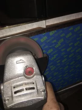

When replacing a fire door gasket, does it look nicer to clean and grind the metal bracket that holds the glass in? A little more work but nice results?
Ripped out the old gasket and cleaned out the old reddish orange silicone with a wire wheel & flat blade screw driver, then masked with masking tape.
I also masked the rope gasket channel so the new gasket will adhere better. :)
Pic 1 - wire wheel rust & dirty carbon and ash.
Pic 2 - grind real smooth with a HF $15 grinder and flap pad.
