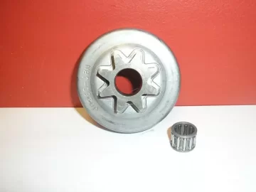

I prefer the rim sprocket, but it requires more care when replacing the chain. When you put a chain on it's possible to miss the rim and when you go to pull start the saw- it'll feel like the bearings are locking up. I think the rim sprockets last longer and allow more consistant chain tensioning. The engine's crankshaft drives the centrifugal clutch, which drives the sprocket, which drives the chain.

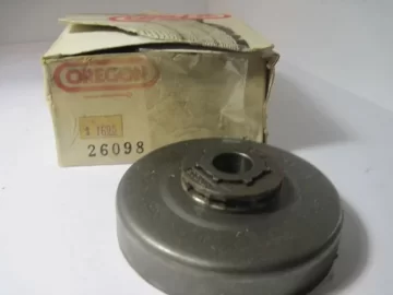

Side play (The rim floating on the drum) is fine. It self-aligns with the bar and doesn't move much after that so long as your chain tension is correct.Mine looks like that but it has a LOT of sideplay, like .1875" per side.
The side play has to be there. When you mount a bar the wood and oil residue may shim it out a little. If the sprocket didn't float the chain would never be in perfect alignment with the bar.That side play makes it easier to get the bar and chain on and off. Like MasterMech said it is self aligning once assembled. If the side play weren't there it would be a pita to use.
My rim sprocket has stood up for more than 30 years.
If you can see marks on the tie-straps (shiny spots) of the chain, your rim sprocket is long past it's expiration date.
Rims are 4 or 5$ at Baileys, just change them out every couple chains.....
You can also try 7 or 8 teeth and see which works best.
that .188 on both sides: Do you mean total back and forth motion of 3/8 inch?
something is not right. it should be much less, maybe 1/8 inch total motion.. Is there a snap ring and a washer holding the rim and clutch hub on?
