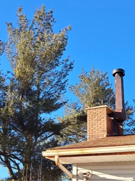

It’s most likely that the smoke smell is being pulled in through doors or windows in outlying rooms. Do you have another fireplace? Got any pics of the chimney?
Chimney was cleaned before we started using this year and again when we noticed the smokey smell getting worse
But are you sure every part of it was? Was every part of the system inspected for problems?

These don’t have much of any secondary combustion in them. They were epa exempt. I have seen this happen in the past with a big napoleon unit, the installer used 6” chimney and that was the issue the whole time. We were able to replace it with 8” from inside the chase. That’s one reason I asked if they had a picture of the chimney.

Okay, gentlemen, cause I'm assuming you are gentleman. I am not. I am a lady. My husband is 80 years old and he is taken care of this fireplace. Ever since the fireplace was put in and the chimney was built, there had been a fire in the house. They built a family room on and put the fireplace in at that time I always have always wondered what the little round knob is that's to the right of the 2. Damper levers that are above the doors on the fireplace. He's pretty certain it runs the flap for the inlet of air but I've never noticed it actually doing anything when you push or pull it or push your pull on it. We have not had a person who's business is chimney's. Look at this for some time outside of as furnace guy came looked at the problem that we have with the white pinesand the add-on that was put above the garage, which then made everything taller than the existing chimney. the white pines are a good 60 feet tall. And last year we had a tornado come through here and it took 3 of them out, which you would have thought would have helped, but really did not because the 60 ft still close to the house. The family room is between the add-on which was put above the garage. And that's probably a good 45 foot tall, and it's easily 25 to 30 feet away from the chimney. The add-on metal extension has not been our finest idea. It did make a difference for a while as to the smoke but that didnt last i feel its worse drawback is the rust, it just gets rust all over everything. It's terrible makes a horrible mess of the siding on the house and the roof is there anything else that I can tell to anybody I'm trying to remember all the things that you all posted? And yes, you had the correct. That is the kind of fireplace, it is. And it was modified to look like a fireplace I'll try and post one more picture. That gives a better idea of the metal add-on that we put on.
Bob says it is clay tile he thinks 10" the damper is metal and then converts to clay tile all the way up

Wow. That’s not correct. No wonder you have trouble with draft.
The damper right above the door is your primary air control, above that is the pipe damper. The 3rd on to the right I don’t recognize. It could be a way to operate outside air that was added by the mason? This fireplace should have a metal class A Chimney system, I’m really curious how and why they added that crazy apparatus at the top.
We added the extension ,built by a furnace man because our chimney wS was obviously too short for the trees that grew up and the addition added over the garage. It did work for awhile, and then didnt
90 degree turns aren’t allowed in a chimney. It’s very suspect! It was cleaned and inspected and not called out as an issue?
I assume you mean the rusty extension in the 90 degree turn? Well it was built by a local furnace company. We had one mason who showed up to look at the job and said well we would have to tear out bushes to set up scaffolding and matching the brick would be difficult. Not any more just apply rust to any brick and it will match. It would have to have quite an extension to it..... and that wasit . I figured there would be another man come that actually wanted to work but it was just the furnace guy and his rusty extension.
At this point I think the rusty extension is your problem. The room addition is farther than 10’ away. It could have an influence, but it’s likely minimal. How was the chimney cleaned? Unless it was a rotary system, I don’t see anyway to verify it’s cleared.
Can't say I have ever seen anything like that extension to adapt to a clay liner, gotta give it to them for ingenuity, but as stated it isn't right.
