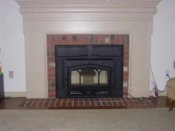

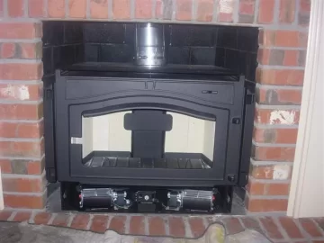

Had my 550 Rockland installed last week (first insert) and it is running well after the intial burn-in period. Install was quick. Nice fit, nice look. Here are a few pictures.
  • [Hearth.com] Jotel 550 vs. Lopi Declaration (Avalon perfect fit)
Yes I do. I also have a hearth extender on the floor as well. I thought these would be an eyesore but I really never focus in on them as they both blend in very well.
Nice shots whaler, the installation looks sweet. Just one thing missing - FIRE! :coolgrin:
