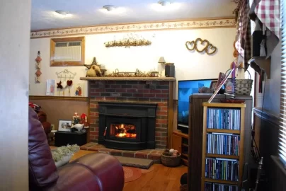

I calculated the 26" spec. The spec is really 11 inches from side of unit (near door handle). I added another 15" to get to the centerline so I could compare centerline to centerline.
I would not be too concerned with hearth depth if you have a raised hearth. I didn't meet the hearth depth so I added a peice of stone to extend my hearth. Because it's a raised hearth, I only needed to be concerned with ember protection for the 18" clearence from the door. See pic.
