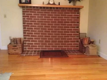

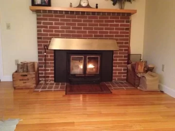

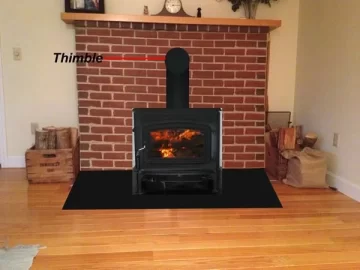

I have decided that we are going to replace our insert with a free standing stove next year and have pretty much decided on the Jotul 55 Carrabassett. As far as installation goes, I would like to remove our current insert and fill in the void left in the brickwork and hopefully make it match. I would like to add a thimble for the new stove and have the chimney lined with whatever the best liner is. Is there going to be problems down the road with this design? What if I have to change the liner in the future or need to upgrade to a different size? Also what type of base should I go with? I would like to keep that simple and maybe use stove board but I am having trouble finding one that will cover the width of approx 60".
Here are some pics of my idea (image of stove taken from someone here) Sorry about my artwork or lack thereof:

Measure this one out very carefully. The thimble will have to go over the damper area. Measure the location of the damper and mark with chalk on the face of the fireplace. Now go up at least 4-5" and mark that as the thimble location. Is this feasible or is it at the crown (just below the mantel) of the fireplace brick? Also, the wood mantel will need to go. It is too close to combustibles. Maybe replace it with a stone mantel. You can make your own hearth pad for the stove. It's not very hard. Or you can buy something from Yoder.
