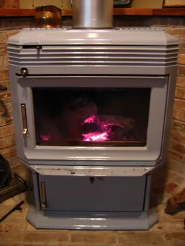

Glad to hear that she's working well for you now. It's an interesting stove. Can you post a picture for us?
Sure - here you go!
Warmly, Al Stearns
Pisgah Forest, NC
USA
  • [Hearth.com] Jotul Alpha goes out when door is shut
Nice! That's an amazing stove. Very nice design. I've seen some sketches of it, but it looks much better in your picture. Thanks for posting!
