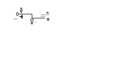

I have the same problem. It seems a flimsy lever, that slides the air control back back and forth. I got my C450 used, but have had to tighten at least once a week. I can live with that for the $1500 discount I got
Put a little locktite on the threads and be done with issue.
I tried that but it wobbles a lot, and still comes loose. This is basically the shape of it. It wobbles at the nut, causing the hook that slides the air cover to slip out of position.
