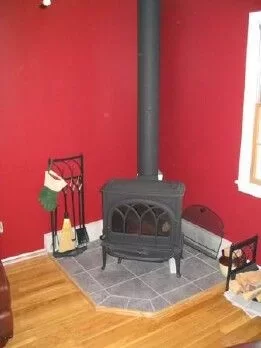

Installed this last week, i am very excited. Pic doesn't show the mantel, 8" wide, 2 1/2" thick rough cut black walnut going from one window to the other.

How is the Castine burning? Do you have a damper in the stack or is this not necessary?
Very nice.
I always see that stove in colored enamels.
I like the way it looks in flat black cast iron.
Paul
Hi PFMG,
Nice install. Beautiful pad. Looks great. The clearances seem a little small for single wall black pipe, but I do not know what the walls are made off.

If that is single wall pipe it is the biggest single wall I have ever seen. That or the Castine shrunk when he lit it off.

It is a double wall pipe. Being it's my first wood stove, i don't have a lot to compare it too. But i am very pleased with it, i have a large cape, the first floor is about 1400 SF and the castine heats it fine, i do use two door way fans to move some heat to the opposite end of the house. It will take the chill out the two bedrooms right at the top of the stairs if it has been on a long time.
It lights easily, and will run at 400-550 all day. I haven't yet perfected the optimal settings for it.
Before i went to the stove shop, i had done some research and had decided on the FC 3B. The salesman at the store suggested the Castine after asking me a lot of questions.
His reason for the castine was, that it can fit bigger logs, up to 18" and has better clearances when used with the heat shield and double wall pipe. So you can basically fit a bigger stove in a same place as you would the smaller one. I am really glad we got the bigger stove now.
I notice you have an OEM door screen. Are there any restrictions on burning with the door open?
Hi pfmg,
Thanks for the explanation. I know little about double wall pipe, (I have single wall on my VC Interpid II) and I asked about it in the store and the price was rediculous. It would have cost me in the range of $300 to upgrade my piping. Mine cost $40.
Moreover, do you not 'loose' a lot of heat up the chimney that otherwise would radiate from the single wall pipe into the living area? If the pipe is insulated (double wall) then the heat in the flue gasses cannot pass through the pipe and heat the living area. With my single wall black pipe, it does. So to me looks like double wall is overpriced and I loose heat too. Or am I missing something? Experts please help.
Carpniels
Carpniels
There is a trade-off. Most modern stoves put about 20% of the heat up the flue to keep things rolling. Exact numbers vary, but they are likely metered for each stove with 'average' black pipe to the chimney distances in mind. If you have a really long run of flue pipe (like in the photo above) to your chimney connection, you might want to consider double wall. Otherwise, you might loose enough heat (into the room) to create a creosote issue in your flue and chimney. Disclaimer: I'm no expert.
