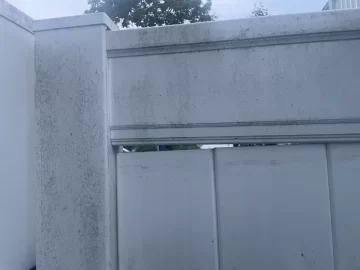

If the gate is vinyl or wood it is not “IF” it starts sagging but “When” it starts sagging and dragging!! In my case, the bottom of the door was just dragging on the ground and it was so very hard to open and close!!

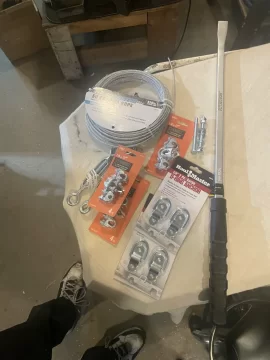

Parts list
Harbor Freight
$13.99 - 28 inch Jumbo Pry bar
$2.99 - 2pc 1/4” Cargo D-Ring Anchor
$9.99 - 5/32 inch X 50 feet rope wire
Home Depot
$7.97 3/8” Zinc-Plated Clamp Set ( Wire Rope Clip - Pack of 3 )
$5.26 Turnbuckle Zinc 3/8” X 10-1/2”
$0.72 Hex Bolt Zinc 5/16” X 3-1/2”
$0.23 Lock Washer Zinc 5/16” (ABF)
$0.16 Hex Nut Zinc 5/16” (ABC)
Total $60.08 but HF has sales and if your an HF ITC member you can get more discounts.
If you have a Prybar then the real total is only $46.09

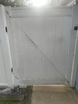

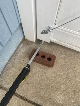

1. Using the lever bar and a brick jack up the latch side of gate so it is even, not sagging and will easily slide into the latch when closing.
2. Assure turnbuckle eyelets are loosened and fully extended so then can be tightened up after the rope wire installation

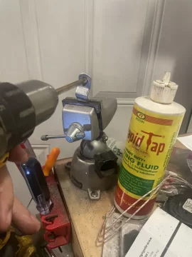

3. Install the cargo D-Ring anchors in the right top corner next to the hinge side. The pre-drilled holes must be reamed out a little with a 5/16” drill bit using Rapid Tap for easier tapping. Also there are long screws inside this fence post gate purchased at Lowe’s. Therefore the top should be taken off to measure how far from the edge and lines can be drawn so the D-Ring flange can be installed on either sides of the screws so there is no interference! Flanges can then be bolted in on both sides with the bolts, lock washers and nuts

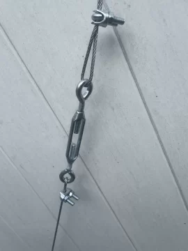

4. Connect rope wire to one end of the turnbuckle with wire rope clip.
5. Measure and connect other end of turnbuckle to bottom left D-Ring flange on latch side of gate.

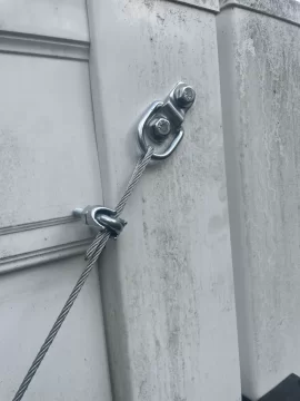

6. Measure and connect other end of turnbuckle to top right D-Ring flange on hinge side of gate.
7. Tighten up the wires by turning the center of the turnbuckle so the eyelets are pulled inwards and wire is taught.

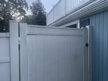

8. Repeat the above steps for the back side of the gate.
All done!!

Pic5 - VinylFenceGate5-LeverBarJacksUpBottomRightfor ProperLatching

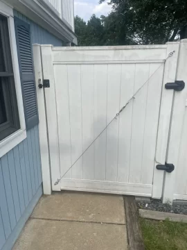

Pic8 - VinylFenceGate8-BackSideGateDoneNoSag
Pic9 - VinylFenceGate9-FrontSideGateDoneNoSag
