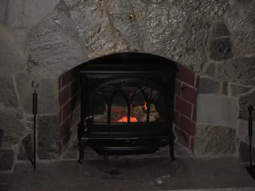

I purchased an F400 and had it installed in early dec. It's installed in my masonary fireplace. I can easily heat the 1700SF first floor of my house. In fact I've used 1/4 of the oil I normally would so far since having it installed. Great stove.. also I've not had any issues with the glass getting cloudy on my F400. Burn dry wood (remember dry wood doesn't sizzle, pop or have water running out the end when your burning it) and you will love it. Make sure you get the ss liner it's worth the money and peace of mind.

  • [Hearth.com] Jotul Castine
