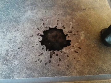

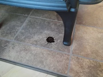

I've got a new Jotul F55 and have burned it a few times. Last night I had a fire going and when I woke up this morning I saw what was a splatter mark underneath the stove near the side. It smelled like soot, but when I looked on the bottom of the stove, I don't see any residual marks where it leaked from. Not sure what to think. I only had the stove maxed out at 450F.

moisture buildup? soot yes?? I just can't see that being paint. Stove paint is quick drying, just doesn't make much sense.
Actually, I had a kettle pot of water on the stove last night and left the lid on it open. There was a lot of moisture coming out, but there's no way that it dissipated in the air and fell to the ground in that formation. I agree, not paint, but soot. We've had a couple heavy rain storms in the last month and it's been that long since I lit the stove. Is it possible water come down the metalbestos chimney and collected in the stove bottom?
Just had the same thing happen with my new Jotul f45 GREENVILLE!!! 2 hot fires and that was the end of the dripping. Must be a coating they use on
the welded steel inner box??
Relax all, it is your firebrick drying out and dripping out of the stove. When shipped the bricks often get wet. This will stop after a few hot fires.
