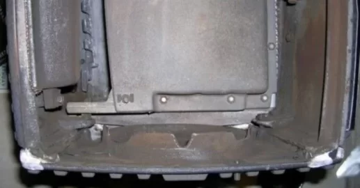

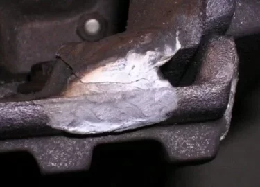

I'm back in the camp of observing uneven burn in the left corner. I've been watching it and continue to see far more reburn on the right. I see a difference in flame color when comparing the right, center and left side. The right and center are usually the same - just less flame, cooler looking flame, less active flame in the left corner. Attached are shots from different times showing unburnt soot that collects on the reburn baffle. This soot tends to burn off everywhere else. I see far less reburn right where these soot is.

Great pictures, Wahoo, they help. The sooting up on the secondary airlets may be the clue. Mine are uniformly light grey. The soot seems to be pointing to the problem. Just a guess, I've never had my secondary manifold apart, but it looks like the secondary air is unbalanced. It's almost like there is air leaking a the bottom back part of the secondary manifold cover. (Where the two bolts attach it to the back. The picture is looking straight at them.) If it were me, I'd stop there and work with the dealer. Tell your dealer that your stove has a flaw and that either you want it fixed to your satisfaction or you want a new stove. There is no way that the owner of a new stove should be triaging the internals of the stove. You have great visual evidence of the problem.

I imagine that area is cooler for some reason. I'll take the pics to my dealer. Hopefully Jotul pays them for customer service effort as my dealer doesn't have 2 seconds for me if it doesn't involve a sale or service.
Well, hopefully by now things aren't quite as frantic at the dealer's. You paid for service when you bought this expensive little stove. If it's not right, they need to fix it. Be sure to document everything so that you have evidence for a warranty claim.
After checking all gaskets and making sure top is level, etc., I'm going to point to the left lug on the log retainer. If you notice, this lug is bigger and deeper into the firebox than the right lug. I gather this is designed to protect the door latch mechanism from heat failure. Because the lug protudes further into the firebox, this causes the pimary air to deflect inward sooner and has a shorter 'trajectory' from front to back. Less air makes it to the back left corner of the box.

hello all,been following this thread.I have had a f3cb for 4 years and prforms excellent but seeing those close up shots reminds me of 2 years ago.Apparently my fire box was held together w/cement and after a year or so the cement let go and firebox actually collapsed-burn shelf fell in and side wall fell outward.Dealer wood not help and threatened to hang up until he walked over to his floor model to see that bolts where supposed to come all the way through the holes in the back w/a nut threaded on and bolts coming through the burn shelf through bolt holes in the side platew/nuts threaded on them.Then the dealers attitude changed from you are out of my svc area to helping me fix the problem.He got me the hardware and did it myself and told him to go pound salt.Point is,most of the dealers really suck,jotul has qc problems but it should be nothing you cant handle.Just came to mind,There is a gasket behind the secondary burn plate if they didnt put it in it will effect your secondary burn.You can check by taking the top off and look along the back wall-good luck,Pat

That stove is very nice, and should do better than that. Just for comparison...the burn tubes on top of my stove are all a uniform gray due to a little fly ash and lots of heating. I can't possibly imagine getting any soot like in your photo.
Yes, I have noticed brown to black soot on the left side of the baffle and I have what appears to be glaze creosote on the left corners of the top as you can see in the photo. Now when I reload, I put extra coals in the corners and I put one log across the top crossways from right rear to left front. That seems to get more flame and heat to the left side of the stove so the gases can release and burn on the back log. If I burn over 500F, the glass clears up a bit, but still cloudy.

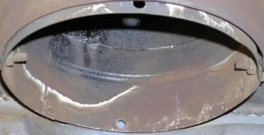

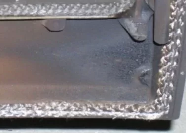

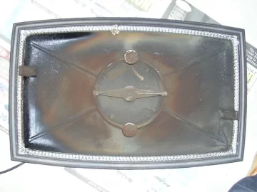

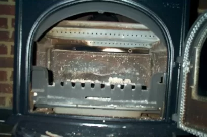

Hey Guys, I have a couple more pics to show you.
In photo one, you can see nastiness on left side of the door.
In photo two, you can see the excess cement with the gasket imprint in it and also corner not filled in. We're going to clean this up.
In photo three, you can see gasket that hawse was pointing out. Yes, we have one but also will make sure it's properly installed all around.

In photo four, you can see nastiness on the left side of the flue adaptor.
I need to minimize the impact a stove on the environment by getting this stove burning as evenly and efficiently as possible. Besides less trips to the wood pile with 18 inches of snow outside is defintely desirable as well. Okay it's melting, but still..

Your lookin pretty good there.It looks as if all hardware is in place,the gasket is there and looks straight-Just dont mess around w/ it to much cause i dont beleive its cemented and it makes a funny little curve at the end.Dont worry to much about the nastiness where they came to a corner with the cement,It just pressed out a little.Great little stove and youll enjoy it more now that you know it inside out.
