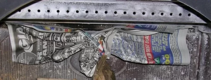

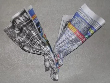

I have a Jotul in the basement and a very strong negative draft with a cold stove/outside metal chimney. We have strong negative house pressure. First there was a ton of smoke in the room at startup. Very discouraging. Here's what I do now and no smoke.
Open air lever all the way
I put down twisted newspaper (burns slower than crumpled to ingnite kindling), two fatwood sticks and 1" kindling, then two 2" and 3" wood on top of that. Then on top of the kindling I put a fan folded (see pic below) against the back wall of the stove. The newpaper touches the baffle, but I'm sure not to let the paper or flames go past the front of the baffle so I push it way back (see pic below)
Then I crack a window a bit (you may not have to do this, but do so if you still get smoke)
Quickly light the top of the newspaper all along the edges of the paper to get it burning as quickly as possible. I use long fireplace matches. The trigger lighters alway go out on me and then won't relight.
Close door to about 3/4 inch until the paper is all burning and you see smoke going up
Open door and quickly light bottom papers only in the front
Close door to 3/4 inch until kindling catches fire
Close door all the way
Close window
If you still have smoke, then get one of those small double box fans about (10" high) and put in the window set to blow air in (reverse) before lighting. This gets rid of negative pressure in the room. Then once kindling is all burning, turn the fan off and close the window.
Let us know how you make out.
