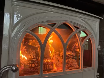

Above is a photo of my F400 with the secondary flames burning quite well last year. Over the summer I did a partial gasket kit and as part of that job I lifted the baffle assembly and put new gaskets underneath the left and right edges. I’ve not had many fires this year so far, but I’ve noticed that the secondary flames barely burn now. I used to be able to open the ash pan door for about 5 seconds, then close it and they’d burn like crazy. I’m concerned I’ve installed something incorrectly or damaged something during the gasket installation. Any insight?

Hmm, i can't tell you what you may have done, but that pic looks like it was an ideal burn.

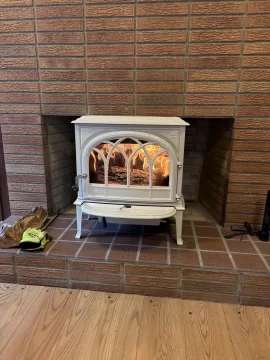

I love how it sits all the way out in front of the fireplace.
