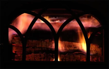

Here is what my Oslo looks like about 45 min after cutting back the air 75% (temp on top is 575)
Different species of wood will give you different results (BTU output ect...) I've laoded it up with Pignut Hickory and hickory gives you nice dancing blue flames almost all the time (esp when the bark is near the burn tubes.)
WoodButcher

Since we're on the subject and WoodButcher was kind enough to provide a photo (thanks!) does anyone else see their logs seeming to turn into giant log-shaped coals within 30minutes of closing down primary? I ask because I routinely see this and am not sure if that's normal. My own VC didn't have a window so for all I know it's always been like that, I just couldn't see it! ;)

Giant log-shaped coals . . . kind of, sort of . . . depends on how much I cut back the primary air and how I've stacked the wood to a degree.
Typically I like to get the fire going really well and then cut back the air and the results will be the BOHH (Bowels of Hell Hellfire) effect with some flames coming off the wood, but most of the flames coming off the secondary burn tubes. As I mentioned earlier if I cut back the air way back after getting the fire going really well I often will get the Northern Lightshow with little to no flames coming off the wood itself, but either a steady or flashing burst of flame from the secondaries.
