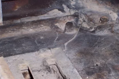

Good suggestion about the ash grate area. Unfortunately it's not uncommon to find abuse by owners using the ash pan door as an air intake to start fires. Clean out the base of the firebox completely so that you can inspect this area carefully. This is what you're looking for. The repair means a complete base replacement and rebuild.
[Hearth.com] Jotul F500 Oslo [Hearth.com] Jotul F500 Oslo [Hearth.com] Jotul F500 Oslo
