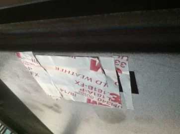

I too have a 26 foot chimney. It goes through the center of the house so it stays pretty warm. I have too much draft in my opinion. The secondary air is unregulated. There's only a 4" wide slot at the back of the stove that feeds the secondaries. When I first got the stove it would over-fire. The characteristics of your install may be different. I used aluminum tape and gradually blocked off the secondaries until they burned well without over-firing. Here's a couple of pics of how I started and where I ended up. Proceed at your own risk and remember that I'm just some knucklehead on the internet.

5. Gradually shut the primary and the damper down until there's just some rolling secondaries and a small amount of flame at the bottom. Close too soon and the fire "falls on its face" (there will just be some flames on the bottom and no secondaries).Usually the temp will get to 600-650 and then slowly drop down. Most of the time I have my primary bottomed (although some primary air still gets in with the primary all the way to the left).

Wow that's really interesting knots. I'll get some aluminum tape just in case I need it. I have the blower attachment coming with mine as well so perhaps that will help regulate it some. I do have a thermometer. I did not get a flue damper. I wonder how much of a pain this will be to add later?

So you use a flue damper and blocked off the secondary air that much? Did you do the damper first or the tape?
Normally new stove modification is neither needed nor recommended.
I got the damper at the same time I got the stove. The guy at the stove store listened to me describe my chimney and said I'd need one. I figured I could always just not use it. He had an F55 heating the stove shop with a lot of chimney and he had a damper, so I went with it. The manual says something about needing one in some installs.
When I couldn't get the stove under control with the damper closed and the primary air at the minimum, I had to resort to choking the secondary air. Other people's installs may not need this.
