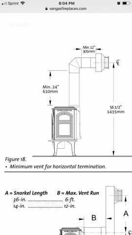

Update:
I checked the orifice, thermopile, thermocouple... they’re all in working condition.
Then, I checked the vent... I removed it entirely and fired up the burner (with windows & exterior sliding doors fully open)... the problem was gone and the unit ran perfectly for 30 minutes.
Put the vent back on, the problem is back...
Any suggestions on how to resolve this?
Thank you!

We have found the problem & it will be corrected by the original contractor.
Cap was unsecured to the venting & the exhaust gases were mixing with
the incoming combustion air stream, & screwing up the ATF.
