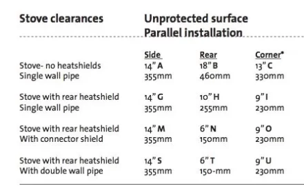

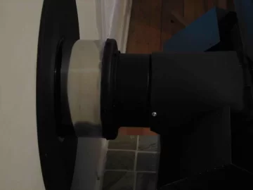

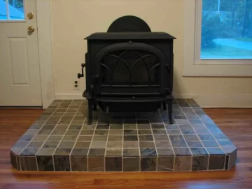

My Oslo has the rear heat shield installed and is connected to the chimney directly out the back. (See attached photo.) According to the Jotul manual, the clearance required with double wall pipe is 6 inches from the end of the rear smoke outlet. (See schematics.) As it is now, I have 7 inches clearance from that point and about 10-12 inches from the true back of the stove depending on where you measure it from. However, after the installers left I realized that the small three inch segment of stove pipe is in fact single wall pipe. (See second attached photo for closeup.) Again, according to the manual, this set up requires 10 inches of clearance from the back wall as measured from the end of the smoke outlet. (At least that's how I personally interpret the schematics of the manual.)

I'm not a fan of taking minimum clearances literally and like to exceed them where it's reasonably possible. It looks like you have plenty of hearth room in front of the stove to scoot it forward enough to put in a 6" section of double-wall and adapter. So consider this an option. Or if you want to stay with the current install, Jotul offers the option of putting a connector shield over the short section of pipe.
The single-wall clearance I think is to be taken perpendicular to the pipe wall, and in that direction you have plenty of clearance since your pipe stub is horizontal. The pictures in the manual are assuming a vertical pipe. Consider that where single-wall pipe meets a thimble or ceiling adapter it is almost always closer than 18" to the surrounding wall or ceiling, just not in the perpendicular direction. The reason this is generally OK is that the radiation primarily travels normal to the surface, give-or-take some diffraction effects. So I think you're fine but if you want some peace of mind slap a little bit of pipe shield over that puppy. The ultimate test is simply to run a continuously hot fire for hours and feel the wall. If nothing gets too hot then you're golden.
