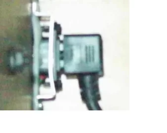

Thanks, dasky. How far back is the junctionbox from the front of the unit? Is this part of the assembly that can be moved to either side? Anyone have photos?

It's directly behind the faceplace. The junction box itself actually isn't the problem.
Jotul uses a funky kinda right angled plug on the end of their power cord,
that sticks out about 1.5" from the side of the insert.

Not yet, but I'll try to get one of our showroom model today,
IF I can get the pix into this forum from my crummy work computer...
Here goes...
The attached view shows the power cord attached to the right side of the unit...
  • [Hearth.com] Jotul Rockland C550 installation width

Thanks for the effort, dasky! I couldn't ask for a better response if you were actually selling this to me! I think this could easily be retrofitted with a flexible adapter. Just not sure what the warranty and code implications would be.
