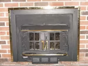

I have similar questions. We just bought a home that has a wood burning fireplace insert CEMI Concept II (picture attached). The glass is broken and I have no idea how these inserts work. I reviewed the thread from 2005 on this specific type but am looking for new information-instructions, where to buy replacement parts etc....any help is appreciated!

Used one for 20 plus years...its in my garage now sitting idle. There is an option of 1 or 2 fans in the blower section...mine has 2 and it moves a good amount of air. The top middle controls the damper plate. The two sides increase or decrease the amount of air to the firebox. Up is wide open for starting. Down is closed for when the box is good and hot. The original papers listed it at 109k btu. Your guess is as good as mine as to actual. The other option is there were glass and mica windows. Glass lasts until it cracks...mica lasts 1 1/2 seasons of hard firing. Make sure you have a good seal arround the faceplate and the brick to keep the heat in the house. This style vents freely into the chimney so it is wide open thru a maybe 14 x 6 inch panel on top. They get a good long burn but do create creosote if you choke it down too far. Nice stove but efficiency is probably 40-50 percent at best so you will use a good amount of wood. I used to use 6 cords or 2 cords a month for 3 mo a year. With the new stove I use 3 cords over 4.5 months. If you get any other questions let me know I will try to answer them. I used to have the sale literature but I think it is long gone now. Good luck!
PS company is long gone. Call the fireplace guys for the mica or the glass for the doors.
Thanks for the info.....I called a fireplace store on the glass before I posted here. They quoted me $100 for the glass per door.....is this price in line?
also....when you referred to using 6 cords of wood...were you using wood as your only source of heat?
100 bucks sound right on with what I was quoted in the Milw WI area. 6 cords did about 85 percent of the heating, maybe 90 depending on how much we were home. If you scrounge for wood then fix it and use it. I got tired of 6 cords a year all split by hand. Now at 4 1/2 and a log splitter life is easy, heck I may even end up with extra at the end of the year. BTW I painted mine. You can use bbq heat paint if you want to change the color. One last thing, take the blower assembly off and make sure the blades are clean, it will make a big difference if there is only one fan and it is dirty. Good luck!
