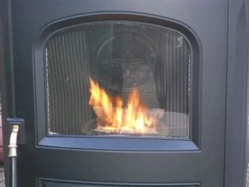

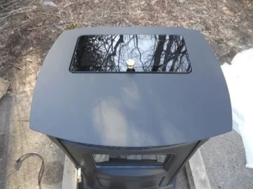

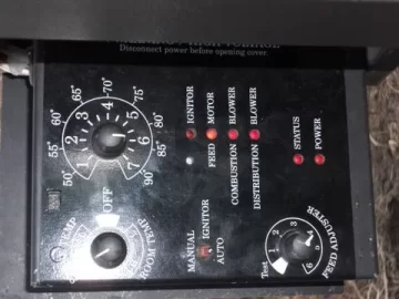

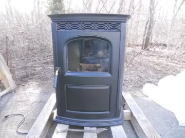

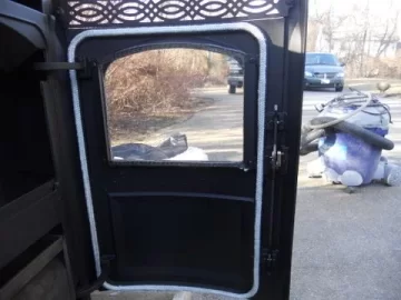

hi all.well with the great weather we've had around here i was able to get the accentra all finished up.i did get the door off and i stripped it down completely.removed the glass and gasket,the door gasket and the door latch mechanism.the inside of the door was rusted up pretty good so i used the wagner paint eater on it and it did a pisser job.i wiped the door down and the following day gave both sides of the door 2 coats of paint.installed new door gasket and window gasket,polished up the glass and reinstalled the latch mechanism.

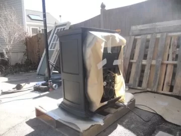

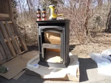

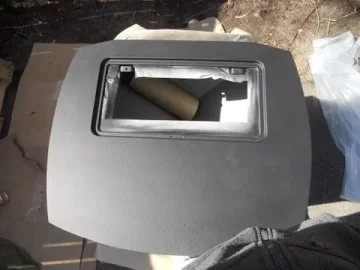

used the paint eater on the body of the stove,removed the hopper lid and covered the remainder of the stove with masking tape and painters paper.gave the stove body 2 coats of paint . i reinstalled the door and hopper lid.

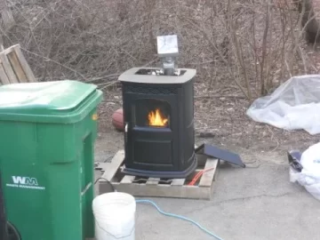

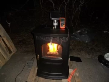

today i filled the hopper half way and let her rip to burn of the new paint smell before i bring her indoors.
the plan was to put this stove in the basement but it polished up so nice that i think the meridian is gonna go in the basement and this will go in the sunroom.
this was my 1st attempt at stripping down a stove and thanks to you all for your help along the way.it was a fun project.
