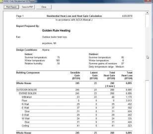

I got thinking about heat loss of an OWB sitting out in the yard and ran a rough calculation on my heat loss software. If the jpeg screen shot attaches here you'll be able to see the calcs for each surface of the OWB. I figured the unit to be 4 feet wide and 6 feet long with a side height of 6" and the ends at 7'. I used R19 in the side walls and R-11 on the ends with a 3'x4' door also at R-11. The top was R-28. I think this pretty much reflects the insulation on a run of the mill OWB. I calculated the heat loss at -6* outside and 180* (that would be the water temperature) inside the structure. I used a poor air change per hour figure that is in reality probably pretty generous.
So just for giggles let's knock it down to 5,000 for easy figuring and also to reflect the fact that the whole winter is not -6* and see how much wood that adds up to over a heating season.
5,000 x 24 hours in a day = 120,000 btu/day. If our heating season is roughly 200 days like here, that's 24,000,000 btu's lost. Factor in an efficiency of 50% (again generous) and you are looking at 48,000,000 btu's worth of heat. That's the equivalent of about 2-1/2 full size cords of wood.
I kinda enjoy helping the boys do their wood (all 4 of em burn) but cutting hauling splitting stacking and then loading that much extra wood every year.............just sayin' ........

YOWZA!!
Add to that a bunch more Btu's lost to some crappy underground lines and you'd have a fine example of a TOTAL waste time and money. Even if you figured the "efficiency" of these things at say 80%(very generous) you would still have a scary number.
Standby heat loss should really be a big part of any efficiency claim.
Thanks for posting,
Noah

If the surface areas are roughly the same, it would probably be pretty close to what i have listed above. I haven't had the opportunity to "sniff" a 23 or 2400 yet so I don't know what the efficiency is. I'm gonna say 60% would be very optimistic based on the difference between CB's past claims for older units vs real world numbers that were generated in an independent lab test and my own.
